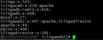

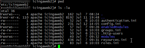

looking in the forum I found some similar threads where they tell to set permissions at “/etc/icingaweb2” correct.
I checked that:
grafik
I checked also the user:
grafik
I’m running Icinga on RedHat so I have to take user “apache” instead of “www-data”.

Can somebody paste me the “ls -al” output of working “/etc/icingaweb2” ideally on a RHEL9 system for comparison ? :pray:
Or is it ok to run the service with user “apache” ?
