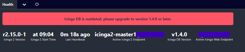

Icinga DB is outdated, please upgrade to version 1.4.0 or later

After update i’ve applied the new db shema for icingadb
/usr/share/icingadb/schema/mysql/upgrades/1.4.0.sql
MariaDB [icingadb]> select * from icingadb_schema;
| id | version | timestamp     |
|  1 |       5 | 1722603000000 |
|  2 |       6 | 1736410757000 |
|  3 |       7 | 1750315860000 |
3 rows in set (0.001 sec)
So the schema is at the last 1.4.0 release but the web return this alert
Screenshot 2025-06-19 110904

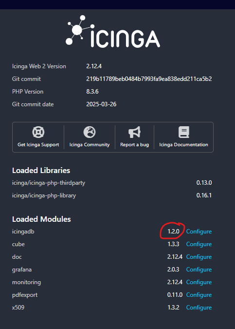

In loaded module i see the version 1.2.0.
Why icinga web detect the old 1.2.0 version? How to fix it?

The icingadb check shows the version of IcingaDB. While what you see in Icinga Web on loaded Modules is IcingaDB Web. Those are 2 separate programs, thus have different versions. In the icinga context, a module is always related to icinga web.
Look at GitHub - Icinga/icingadb: Icinga configuration and state database supporting multiple environments and GitHub - Icinga/icingadb-web: Icinga DB Web – UI for Icinga DB – Provides a graphical interface to your Icinga monitoring
Thanks for bringing forth this issue. It is tracked in IcingaHealth: Icinga DB Version Check Is Broken On Debian Package Build · Issue #1230 · Icinga/icingadb-web · GitHub and we are aiming at releasing a fix soon.
A new Icinga DB Web release, version 1.2.1, was just released and uploaded to the package server. Please install this update.
Thanks for all your reports!
The patch works fine!
