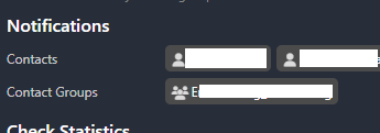

Do you see something like this on your hosts and services:
hi Dominik as requested, yes i used director….but i dont see any contacts or contact groups under host or services…my version maybe a lower version of icinga

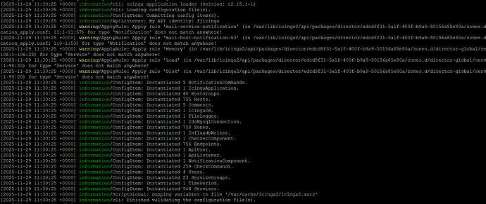

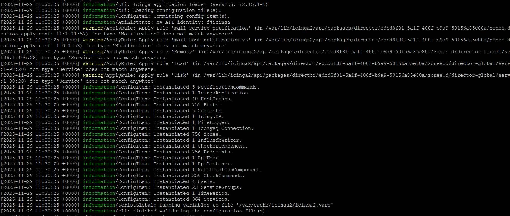

icinga2 daemon -C --dump-objects
I think you need to remove this or they will not be attached / created.
This is something that you can use to disable / enable at hock in the Web GUI and IMHO shouldn’t be used in your config. If you created your own enable_notifications then it would be under host.vars.enable_notifications.
The warnings in your screenshot
hi @rivad can please advise what i can put as the assignment fill cant be empty i removed the statement and put below and reload icinga2 via systemctl reload icinga2
