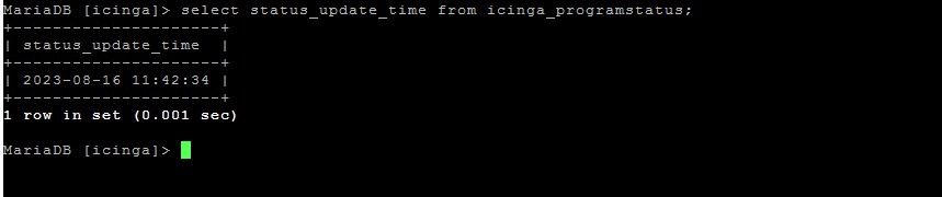

I have seen this
My this table is updated, and properly sycned, Whats the issue then
