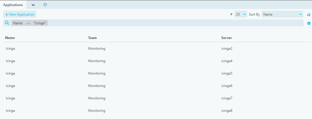

I had quite the fight to get a n:m relation working in the module I write.
And now I would like the servers be grouped so that the application rows aren’t duplicated, when an application has more then one server.
So from
to
Is this possible via ORM in the SQL query or do I need to group the data later via PHP?

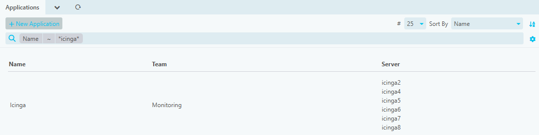

and if I access the data with with(['server']) I get duplicated lines, one application row for ever server, that’s associated with it.
Are you just talking about moving the server lookup, from the view, into the controller or model?
I guess, it would be cleaner but still not integrated with search and sort, until I can get the “GROUP BY” it into the main query.

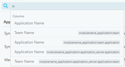

Maybe, there’s a better way and I still get search filters, that result in invalid queries but possibly I added to many relations by now.
