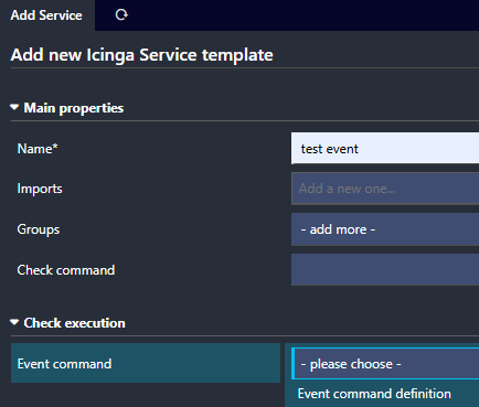

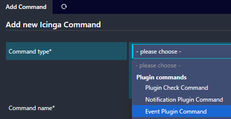

Only after you create an “Event Plugin Command” will you see the option “Event command” under check execution.

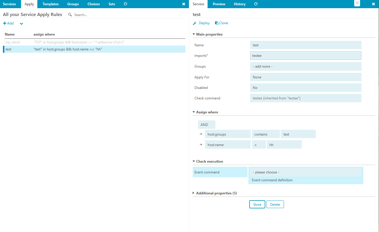

you can use the service apply rule feature and apply different services for different variables / conditions.
Thanks this was solution i passed a variable to my command and thats makes the dission.
