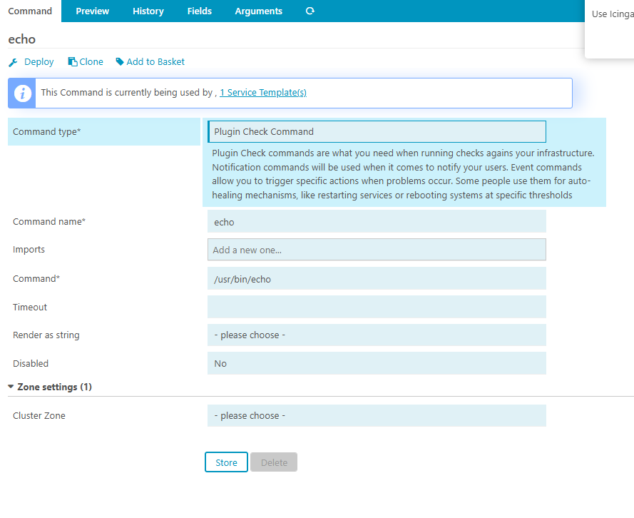

a command that executes /usr/bin/echo:

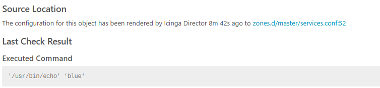

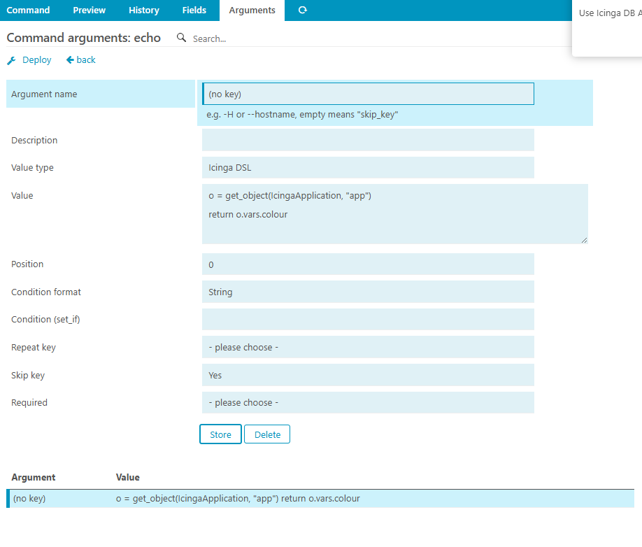

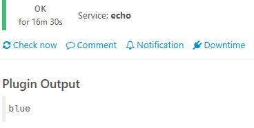

an argument with no key and the value generated by icingadsl:
o = get_object(IcingaApplication, "app")
return o.vars.colour
IcingaDirector supports icingadsl only for command arguments.
