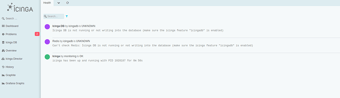

Getting error "Icinga DB by icingadb is UNKNOWN Icinga DB is not running or not writing into the database"
Installed icingaweb2 and configured as per the doc but getting error in dashboard

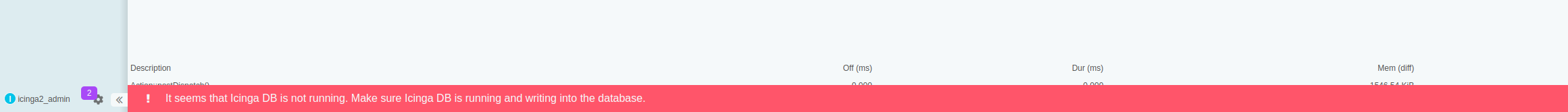

It seems that Icinga DB is not running. Make sure Icinga DB is running and writing into the database

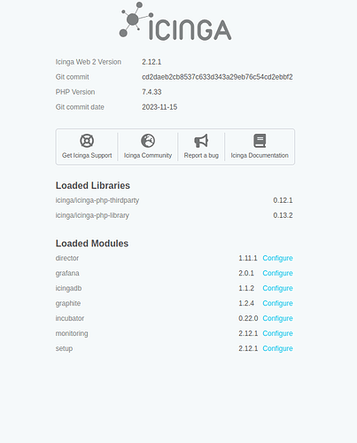

I have attached the details, please let me know how to proceed
