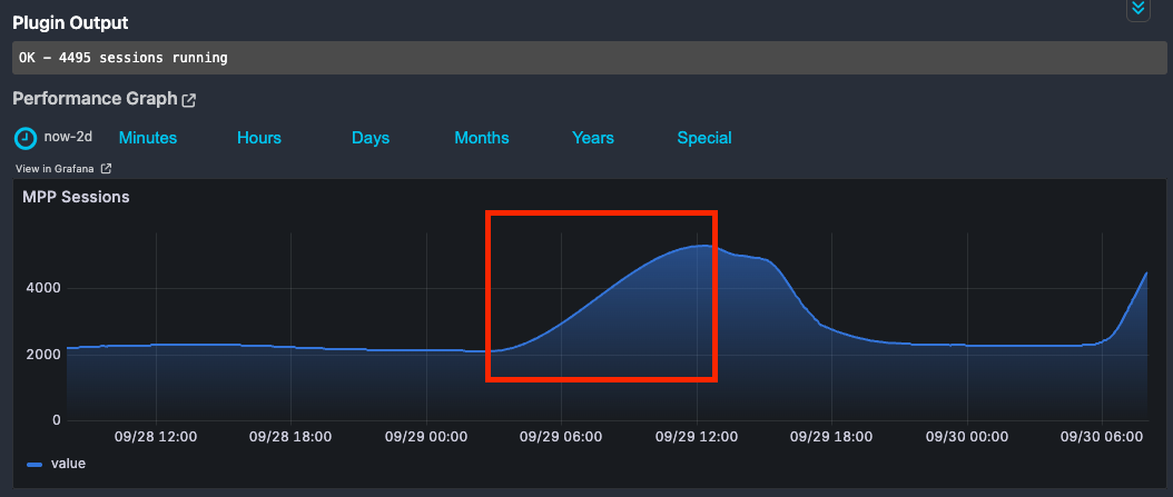

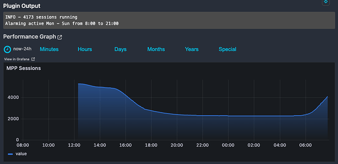

We started monitoring our infrastructure with Icinga2 and display performance metrics using Grafana and InfluxDB. It kind of works, but sometimes there are gaps in the graph:
This service is monitored 24/7 with an interval of 3 minutes. Yet if I look at the past 24 hours, the graph only appears at 12:18.

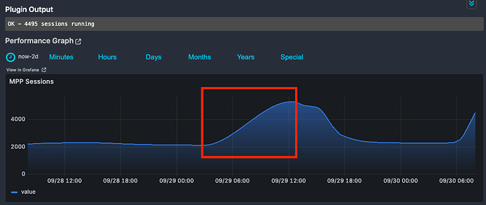

If I zoom out a bit, it looks better:
But if I hover over the graph, I see that there are no data points between 29.9. 2:50 up until 29.9. 12:18.
The service checks are executed every 3 minutes. Sometimes Grafana/InfluxDB is randomly missing performance data
But I can’t figure out why we don’t get the performance data to display…
Has anyone faced the same issue or knows how I can solve it?
