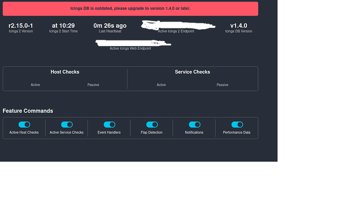

Today I created a new system with Icinga2 and Icingaweb2. Unfortunately, I can’t get Icingdb to work. The error message is: “Icinga DB is outdated, please upgrade to version 1.4.0 or later.”
The screenshot shows that version 1.4.0 is running.

Hi @Rico,
that would be this problem. Your setup is probably ok, this is a bug (which should be resolved shortly).
A new Icinga DB Web release, version 1.2.1, was just released and uploaded to the package server. Please install this update.
