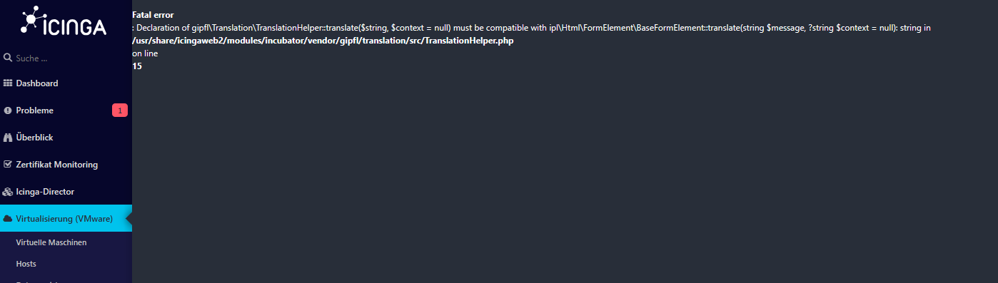

I get a Fatal Error, when I use “Virtualisierung”.
I need help to resolve this problem:

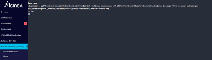

Fatal error: Declaration of gipfl\Translation\TranslationHelper::translate($string, $context = null) must be compatible with ipl\Html\FormElement\BaseFormElement::translate(string $message, ?string $context = null): string in*/usr/share/icingaweb2/modules/incubator/vendor/gipfl/translation/src/TranslationHelper.phpon line15***
What does this error mean und how can I resolve this.

Same error with clean installation.
Debian GNU/Linux 12 (bookworm)
icinga-php-library/icinga-bookworm,now 0.19.1-1+debian12
icingadb-web/icinga-bookworm,now 1.4.0-1+debian12
Is there a solution?

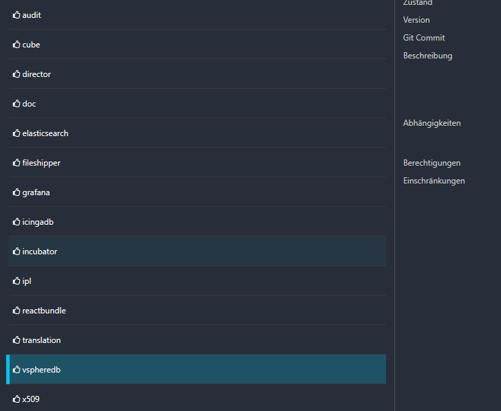

Can you show us the Versions of all installed modules?
Hi.
Thank you for your reply.
I was thinking more about php libraries, like icinga-php-legacy etc
