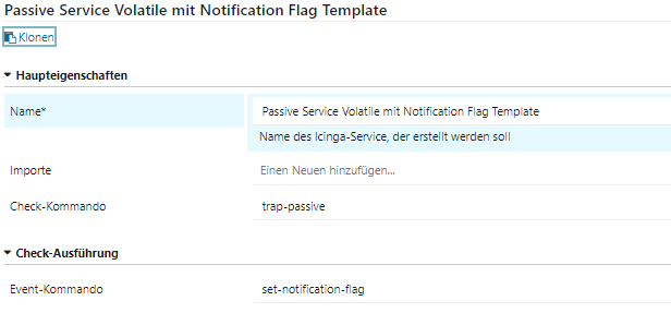

Then i added the new eventhandler to the service template:
template_passive
template Service "Passive Service Volatile mit Notification Flag Template" {
    check_command = "trap-passive"
    max_check_attempts = "1"
    check_period = "timeperiod-24x7"
    check_interval = 1d
    enable_notifications = true
    enable_active_checks = true
    enable_passive_checks = true
    enable_event_handler = true
    enable_flapping = false
    enable_perfdata = false
    event_command = "set-notification-flag"
    volatile = true
    vars.enable_trap_notification = true

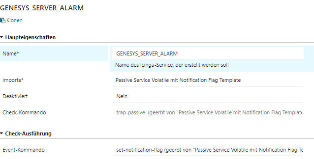

At last the service:
service
