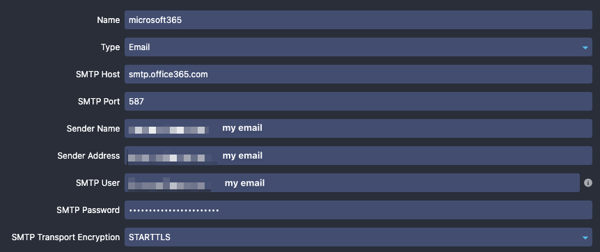

does icinga-notifications depend on a local postfix service configured as SMTP relay? I try to use MS365 SMTP authentication, which is working for other services. I only filled this fields:
No, the email channel speaks SMTP itself and uses the configured SMTP Host.
However, your error message when using STARTTLS seems to be O365-related. Based on similar web results[1], you have to use Microsoft’s so called Legacy SMTP endpoint.
  1. https://learn.microsoft.com/en-us/answers/questions/1276627/smtp-authentication-error, https://learn.microsoft.com/en-us/answers/questions/788460/504-5-7-4-unrecognized-authentication-type-(with-o, and many more ↩︎
unfortunately also this endpoint does not work.
Maybe the authentication method of the channel is not “plain”.
I’ll move on to setup smtp-relay with postfix.
Thanks anyway!
smtp-relay with postfix and configure the notifications-plugin to use localhost on 25 without authentication worked :grinning_face:
