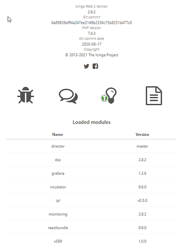

System information:
Platform: Ubuntu
Platform version: 20.04.2 LTS (Focal Fossa)
Kernel: Linux
Kernel version: 5.4.0-42-generic
Architecture: x86_64
Internal paths:
Disabled features: command compatlog debuglog elasticsearch gelf graphite icingadb livestatus opentsdb perfdata statusdata syslog
Enabled features: api checker ido-mysql influxdb mainlog notification
