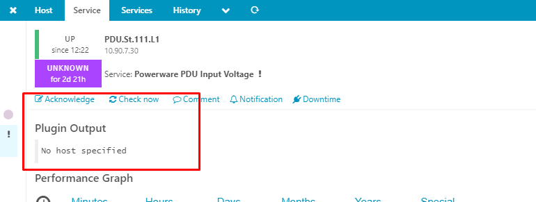

have this error.
used check_snmp
icinga2error
How fix this error ?
The error message notes that there is no host specified, it might help if you share how you configured your check.

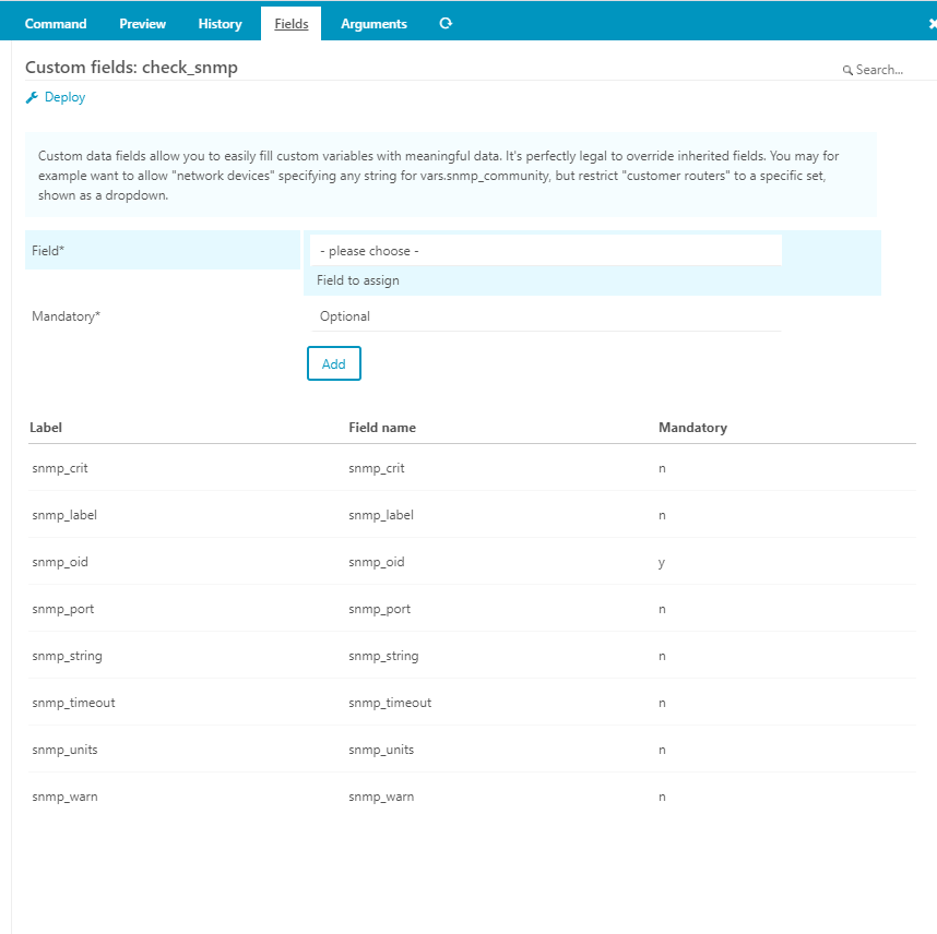

here is my settings
I give u screen my settings.
U can help me ?
I can’t see a command definition, nor a service template “PDU Input Voltage” where you then import that definition. The command definition has a command field that basically describes how the command is called up. It looks like you are missing an argument there.

P.S.: I just saw only now that you already seem to have set up a normal (not external) command definition “check_snmp” from your first bigger screen capture picture in your 3rd post above. How about showing the “Command” tab of that command definition please; also add the Preview tab of that!
P.P.S. (late edit): A “command definition” is also mentioned in your linked example, if you scroll all the way to the bottom. Probably using a direct .conf file, though, i.e. not via Director. It is BTW not a good idea to mix direct .conf usage and Director configuration, unless you know exactly what you are doing; as a beginner, choose one or the other method for configuration, for everything.
Wow! You are using the self-defined command like an external command, doing everything via arguments. BUT: That argument list that you have there (1st screen capture picture in your last post) means that ALL those arguments are being set up separated by spaces every time your check plugin is called up! So all those variables you use there would also need to be filled (e.g. $snmp_address$, which you have not defined as a field - use just $address$ instead on that “-H” argument row! (Std. Icinga variable for the host address))!!
Better to get rid of those argument rows in the Arguments tab, that you don’t intend to use! So that you don’t have to define all those variables/“fields”, which are currently inserted as empty strings in your long arguments list on call-up…
P.S.: As I said, start from how you would call up your plugin in the shell. Then build only those option( argument)s into your command definiton, using variables/“fields” for values that may change from host to host.
