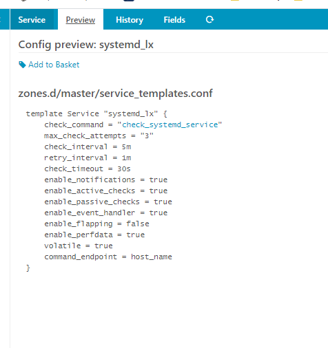

Looks like you created a new command check_systemd_service_2. Can you show us the resolved configs for host, service and command (via Object → Preview → Show Resolved)?
grafik
hello @ritzgu
host
service
command
from the inspect
What about the command defintions for “check_systemd_service” and “check_systemd_service2” you showed earlier. Which services reference them? I can only see a command defintion for “systemd_service”. (That would explain why the checks can’t find them)
