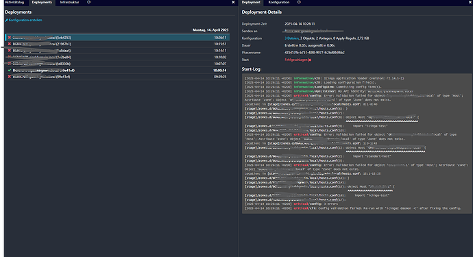

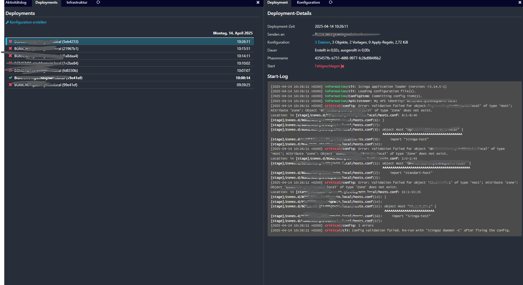

Hi:) I am currently working on intregrating Icinga into our Company. Its my first project and i do not have a lot of knowledge regarding linux and systems such as Icinga. So now i basically configured everything as in the main tutorial and i can access IcingaWeb without any problems. Now i looked at the Icinga Director Setup Walktrough and i did everything as shown.
This is the deplyoment log!
I blacked out the fqdn, and ip adresses but if you need any more information to help me out, I am happy to deliver!
Any idea why i cant actually create a Host, or even ping a host?

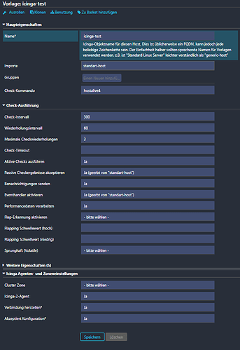

You need to set Icinga2 Agent of that host object to yes.
Hello, thank you for answering so quickly:)
I tried that but I still get this
This is a Host Configuration i made:
And this is one of my Templates:
I tried that, i even changed it in the template and in Host i tried out activating the icinga2Agent only and i tried out activating the other options such as accept configuration and cluster zone. I posted my configurations below:)

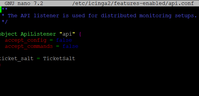

In my API.conf it says false, is it possible that this is the problem?
If so how do i fix it? Because the feature is enabled!
No, that’s another topic.

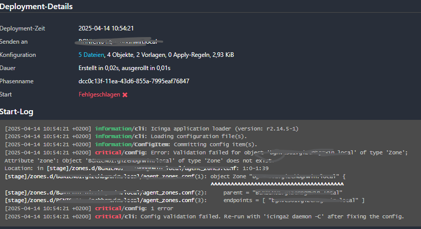

It’s difficult to help here since you have redacted details (BTW: you missed that at your second screenshot on the top). I’d assume you use capital letter(s) within you host name and this will not work for Windows machines.
I appreciate the help anyway, and i will try to change the capital letters! Thank you

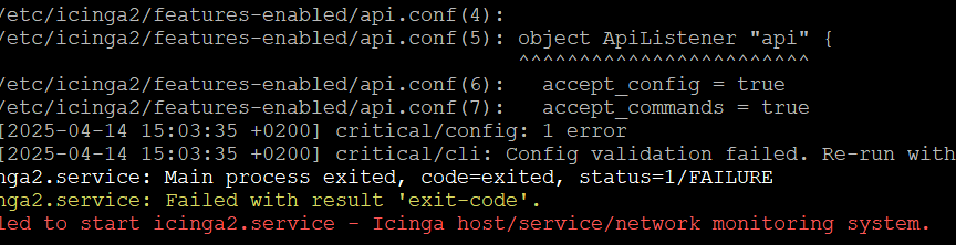

Hi i changed the capital letters to normal for the fqdn normal name. Now my icinga2 wont start and is stating that there is a problem in the api config. Apparently its in etc/icinga2/features-enabled/api.conf(5): object ApiListener “api” . Any Idea?
I don’t know what you are doing. Changing the hostname in the director does not have any impact on service (re)start.

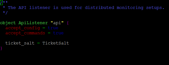

The problem is that i dont know what im doing myself! So i just took an older snapshot and everything is back to normal. I still want to ask you one question because i get this:
Whenever i am trying to check the status of icinga2. Hope i explained correctly
The API Config looks like this
I dont see anything wrong
You need to check icinga2.log. I’d assume you have a certificate error.
