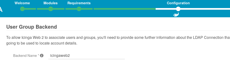

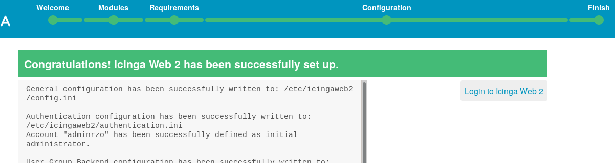

I have install and configure Icinga2 and Icingaweb2 on Debian 10
STEP1
STEP2
STEP3
STEP4
STEP5
STEP6
STEP7
STEP8
STEP9
All configuration is correct but when I try to connect to icingaweb2 with my account on LDPA.
I have a message
Incorrect Username or password
But my username and password are correct.
Thank you for your help
