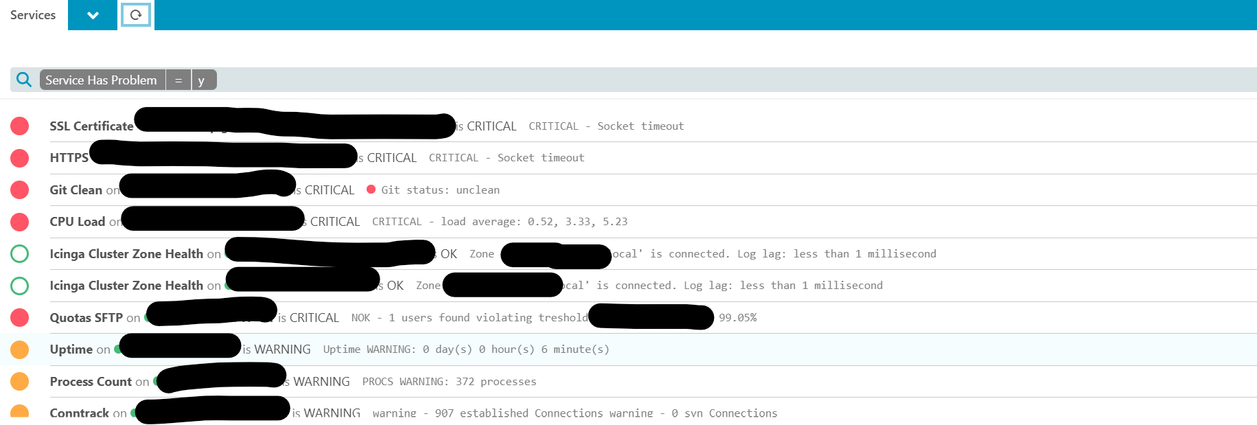

Dashboard with "has Problem Filter" shows Services being OK
  • Web browser used: Any
  • Icinga 2 version: 2.14.6
  • PHP version used (php --version): 8.2
  • Server operating system and version: RHEL8

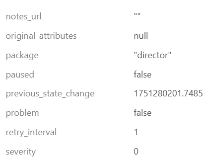

Expectation: Dashboard show only Services having the Parameter Problem: true
Problem: In the last 2 releases of Icinga I had this Problem already 3 times. The Dashboard shows Services being OK or having the Parameter Problem: false in the Dashboard. The Dashboard works only as expected after the icinga2 Service is being restarted.
