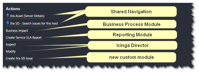

We’ve created a custom module that creates a new action under the “Action” headline which is working fine.
Besides that new action link there are a couple of other links from modules and shared navigation links, that aren’t sorted by name.
Is there a way to sort the entries by name and add an icon that’ll help finding links more easily?

I dont know about sorting, but you definitely can add icons.
Either on the Add Host Action button in the UI:
Or in a web module:
            new Link(
                [new Icon('globe'), $label],
                'map?showHost=' . rawurlencode($host->name)
You can see here how it uses the globe icon in the code for the Host Action. I hope this gives you an idea.
Thanks a lot for that hint @bberg !
I can now use an icon from the IPL.
Anybody else with hints for custom icons and/or sorting options?
