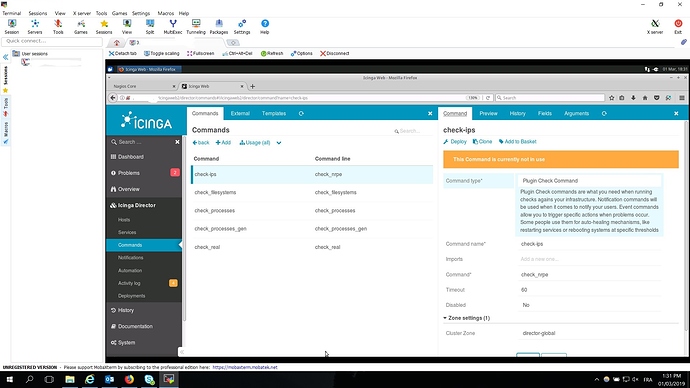

Although I read a lot of other posts on the subject, I’m confused about how to implement this.
If I have this command (from Nagios)…how would I define it in Icinga?
***My biggest concerns are the “command” textbox and the Arguments tab.
In the attachment I’ve provided, should my Command field be check-ips or check-nrpe?

command-check-ips|690x388
Welcome to the glamorous world of Icinga. :slight_smile:
The good news is, you don’t need to create a lot of commands anymore like you had to with legacy tools like Nagios.
Icinga 2 allows for creating a single command which knows all options of the plugins but only uses the ones you really need.
So you don’t have to create check-ips, you can just use the nrpe definition from the ITL you already imported into Director. You just tell it which command to use from the nrpe.cfg file.

the things @twidhalm explains with automation with chef and also the Icinga agent are totally valid, but still overwhelming imho. At first glance, you need to understand the differences between legacy (Nagios) and the current Icinga DSL format, especially in the way of passing command arguments.
There’s a couple of pre-defined command templates available in the ITL, so you don’t need to waste extra time with defining things others have done multiple times already. One of them is nrpe, amongst others like disk, load and community contributed definitions for famous check plugins like nwc_health or mysql_health.
I would assume that your current setup still runs while you’re migrating to Icinga, and as such, the NRPE daemon on the agent is still running.
For the first success with Icinga, I’d just implement the service in the Icinga way and then you may consider modern and secure agent communication with Icinga (TLS, endpoints, trust relationship preventing MITM attacks).
Analysis and Migration
As you know already, nrpe is there, and following your CheckCommand
command_line $USER1$/check_nrpe -n -H $HOSTNAME$ -t 60 -c $ARG1$ -a ‘$ARG2$’
there’s some things to consider:
  • -n disables SSL/TLS, which is totally bad. For migration purposes, the nrpe command requires the nrpe_no_ssl attribute set to true
  • -t 60 sets a hard timeout to 60s, this needs the nrpe_timeout set to 60s.
  • -c translates into nrpe_command which is passed as $ARG1$ in the command line
  • -a adds additional parameters on the command line (which must be enabled on the agent host)
The service itself adds the values for the two $ARGn$ macros in the old world.
check_command check-ips!common_check_ip!-i 205.189.10.21,205.189.10.22
The above typically is bad practice, as it allows the caller to pass any shell command with -a and the remote end executes that. Compromised masters may abuse this to read secrets from the attacked host.
Anyhow, we know that the nrpe_arguments in Icinga pass -a as arguments, thus requiring an array.
  vars.nrpe_arguments = [ "-i", "205.189.10.21,205.189.10.22" ]
In addition to that, the remote called nrpe command is just a string.
  vars.nrpe_command = "common_check_ip"
