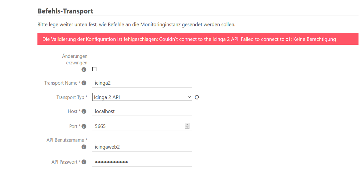

Couldn't connect to the Icinga 2 API: Failed to connect to ::1: acces denied
Hello!
I am new to icinga. i ve Installed Icinga 2.
i am nw setting up icingaweb 2 and got this error message. checked my conf files and I am sure my password ist true. in the future list ist api activ.
can anyone help me

  1. localhost instead of ::1
    that´s what I did
