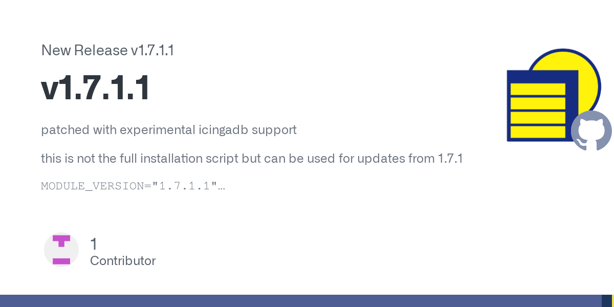

As for icingadb support you can try out this:
but since there is also a newer ticket / merge request for a CSP problem, this is of course not addressed here.
