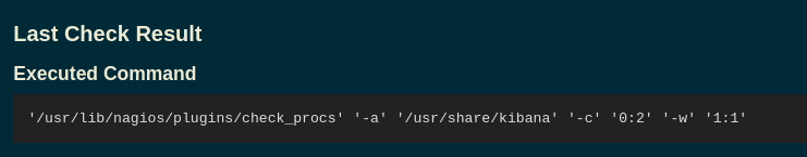

  2. When I run the check directly on the target running as the nagios user (or as the root user), I get an accurate result… but when I run the test via Icingaweb2 I get a 0 back no matter what. It’s almost like the check isn’t even running on the remote host maybe?

Which seems to yield the following check command line:
nagios@elastic01:/root$ '/usr/lib/nagios/plugins/check_procs' '-a' '/usr/share/kibana' '-c' '0:2' '-w' '1:1'
PROCS OK: 1 process with args '/usr/share/kibana' | procs=1;1:1;0:2;0;
However, when Icinga2 runs it… it always returns 0, which SHOULD be a CRITICAL not a WARNING.
