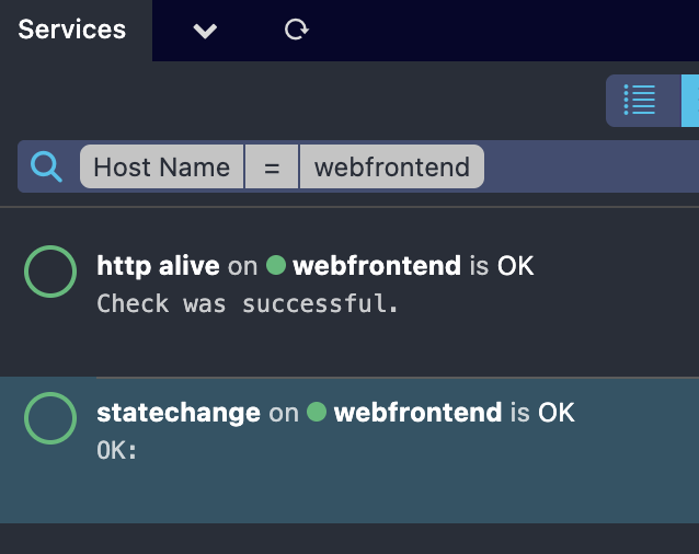

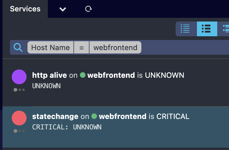

I just did some kind of Proof of concept how something like this could look like. At least as far as i understood the issue.
Basically, its a service that changes its state and plugin output depending on the state of another service. Yes, in my PoC this would be 2 services instead of having one service.
So, as you can see both services are in the same state if http alive is in state 0 (or 1 and 2). However, if http alive is in state 3 the service statechanger becomes state 2.
Here is my icinga DSL config for this:
