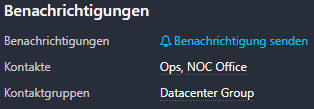

Hi there,
I’m trying to change or add an contact to an host for notification but i’m not able to do so.
Maybe my API call is wrong or it isn’t possible at all?
Here i already changed those Parameters via API successfully
via
curl -k -s -S -i -u user:password -H 'Accept: application/json' \
-X POST 'https://localhost:5665/v1/objects/hosts' \
-d '{ "attrs": { "vars.ping_wrta" : "200", "vars.ping_wpl" : "10", "vars.ping_crta" : "300", "vars.ping_cpl" : "20" }, "pretty": true }'
-d '{ "templates": ["generic-host"], "attrs": { "vars.ping_wrta" : "200", "vars.ping_wpl" : "10", "vars.ping_crta" : "300", "vars.ping_cpl" : "20" }, "pretty": true }'
But now trying to add here additional OpsGenie
via
-X POST 'https://localhost:5665/v1/objects/hosts/hostname' \
-d '{ "attrs": {
"contacts" : ["datacenter", "opsgenie", "sound" ],
"contact_groups": [ "datacenter" ]
"pretty": true }'
-d '{ "templates": ["generic-host"], "attrs": { "vars.notifications_opsgenie": "true" }, "pretty": true }'
-d '{ "attrs": { "vars.notifications_opsgenie" : "true" }, "pretty": true }'

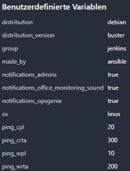

Here are the Variables used and we’re using the three Notification Variables to manage the same notifications on the services of the host.

But here are the applys for the Notifications (if they help):
apply Notification "notify-opsgenie-host" to Host {
command = "opsgenie-host-notification"
users = ["opsgenie"]
states = [ Down, Up ]
types = [ Problem, Recovery, Acknowledgement ]
# assign rules
assign where host
assign where host.vars.notifications_opsgenie == "true"
ignore where host.vars.notifications_opsgenie == "false"
apply Notification "notify-opsgenie-service" to Service {
command = "opsgenie-service-notification"
states = [ Critical, OK ]
# assign rules
assign where service.vars.notifications_opsgenie == "true" && service.enable_notifications == true

dcz01
June 27, 2025, 10:37am
6
Thanks for that clearification.
But we’re not using the Director and only managing all files directly via DSL.
We create new hosts via Ansible over the API and then we’ll using these variables exactly like
