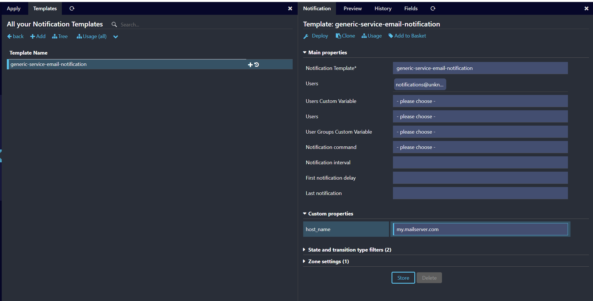

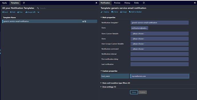

The template is defined in my system
The host property is defined. I also can’t delete the template and start from scratch as the delete button is greyed out.

just to find out if that works:
can you clear the hostname, save and remove the the field from the the template?

Thats the problem. As it stands right now, I can’t deploy any changes. I just get that error.
did you do that?
Best regards

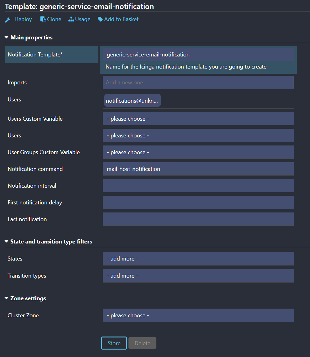

Yes, I did that and the delete button is still grayed out on the template

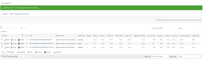

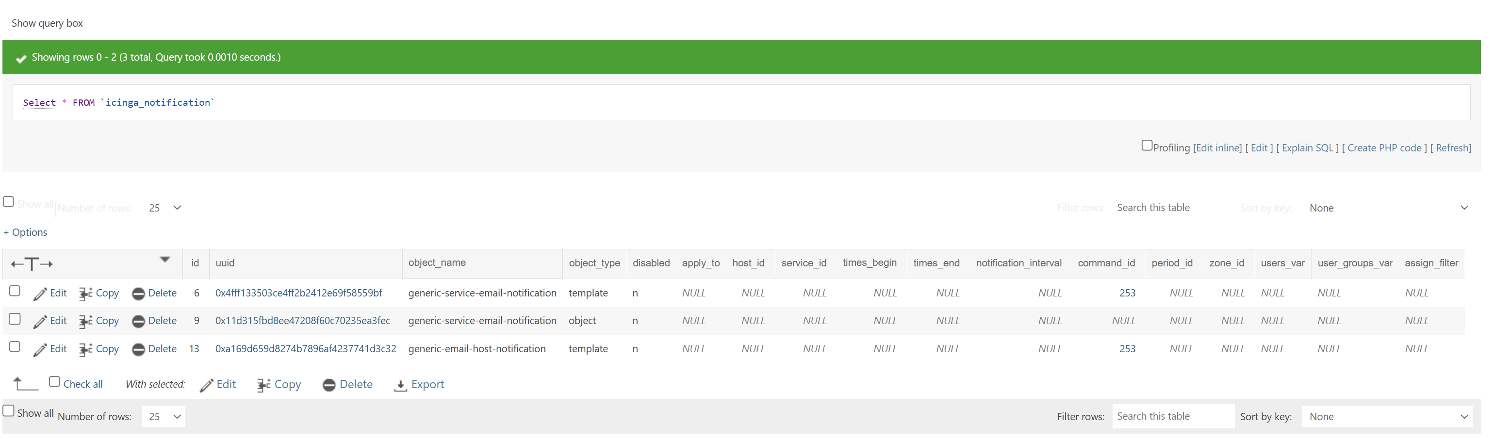

Whats the output of:
Select * FROM `icinga_notification`;
executed against the mysql director database?
Three rows, as depicted below:
Should I delete the object row? I am not sure how that got out there.
Make a backup first!
And definitely delete the object_type=object, since “notification rules” in director are either object_type=apply or object_type=template
Deleting the object row totally fixed the problem with deployments. I am not sure how that row got out there, but I really appreciate your help in getting it cleaned up!
