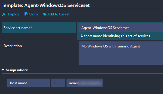

Attache the services via a condition in a service-set that takes effect because of something you set on the VMware side and shows up in “Custom Values and Tags” in vSphereDB.

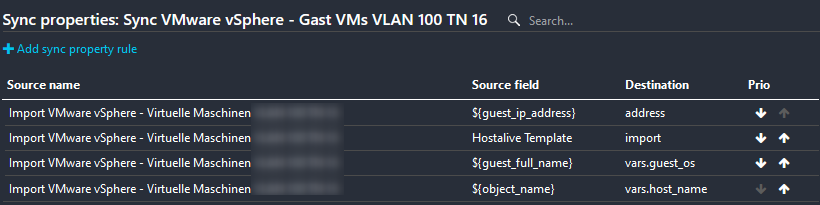

Its my Sync properties

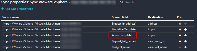

this works but is removing at next sync

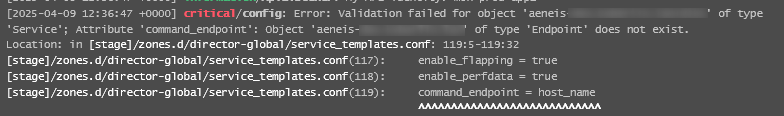

and the problem
It shouldn’t matter if you have the services in a template or a set.
It looks like the host didn’t create an Endpoint in the zones.conf.
I found a solution
I added simple clone from my hostalive template where the ping command is removed and “Icinga2 Agent” field is set to “yes”
