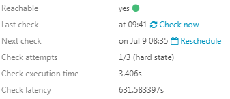

Describe the bug
Service check reschedule is not working. It does nothing.
To Reproduce
Provide a link to a live example, or an unambiguous set of steps to reproduce this issue. Include configuration, logs, etc. to reproduce, if relevant.
  1. Select a service
  2. Click on “Reschedule” button and set next execution
  3. Check if “Next check” time changed
Expected behavior
Expectation is to be executed when scheduled but nothing changes.
Screenshots
Check next check time:
Reschedule, in this example 2 hours later:

Sorry for that but is the same issue and my first post here.
We have IcingaWeb2 v2.6.3 (installed on a web server) and two cluster nodes running r2.10.5-1. Then we have various satellites, one per site, all running same version like the cluster nodes.
Please help me collect the logs with traces and any other data you need.
Thanks

The checker component logs about specific forced schedules, looks for lines starting with Scheduling info for checkable. If the checkables are missing from that, also verify that NTP is running and all instances and their time is in sync (ntp checks as listed in the “monitoring Icinga 2” chapter in the docs.
I checked the time and is synced on all four nodes:
Then I enabled debulog on all four, clicked on Reschedule button in IcingaWeb2 and looked for the service name, nothing on the sattelites:
If I look for Scheduling info for checkable there are several entries but none of this service.
Can you repeat the curl call on all endpoints and check whether the configuration objects really exist on the satellites?
root@mqde01icinga2cl01:~$ curl -k -s -u root:icinga 'https://localhost:5665/v1/objects/services/mqde01pspweb01!APP_SP_Nintex_Workflow_Maintenance'

Looks good. The only thing which irritates me is that forced_next_check is set to false. When rescheduling a check, are you forcing it? If not, the scheduler will just re-insert it into the queue according to the best possible check interval, not immediately execute it.
This is the output after Rescheduling the check with Force option, now force_next_check is true, but still, nothing changed in IcingaWeb2:

The endpoint with the last line has paused: false set being authoritative, inspect this one being operative. Are all checks late, is there any problem with the instance itself?
Sorry for the late reply. I checked wk02 endpoint and is operative and working. But I can tell you that almost all the time we have late checks (Overdue dashboard si full of late host and service checks), Next check value is negative, up to -10 min. Is there way to improve this?
Take your time. This topic isn’t one of these which are easily solved without having direct access to your environment. I am doing my best, but it is hard.
I would especially check the cluster communication. Since you’re saying that those reschedule events are never processed, it might be that everything is piled up.
This includes:
  • How many hosts/services are checked by this specific satellite zone
  • Which underlaying hardware is used (CPU, RAM, etc.)
  • /v1/status/ApiListener via REST API, especially the json_rpc clients.
  • Logs which include the JsonRpcConnection queues logging their items and rate of processing
  • Network traffic in general, how’s the graphs
  • Slow processing of data inside Icinga itself, e.g. when you reload the satellite, how long does it take to fully sync it again with the other endpoints.
  • Is there replay logs which are never processed, or holding off the sync mechanism? Check the content of /var/lib/icinga2/api/log and ensure that rotated files are deleted once sync completed.
  • Does the satellite have any sort of API clients connected to it, via HTTP? E.g. some scripts sending in check results
  • Last but not least, generate a full gdb backtrace from that satellite when it is running and you have sent the force next check. Not a bug hunt, and you won’t understand much of it, but maybe I can see a glance of a locked wait in there.
