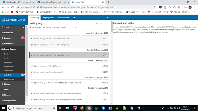

Strange and false fpm-php error when try to deploy
i’ve this error when try to deploy.
Obviously it’s false because the fpm-php is working correctly as icingaweb2

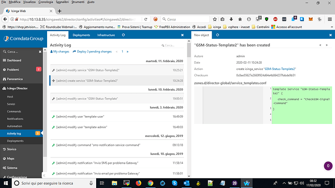

As you can see if i click on the deploy object i’ve the php error on right view,but if click on other two deploy above i see regular output (second attach)

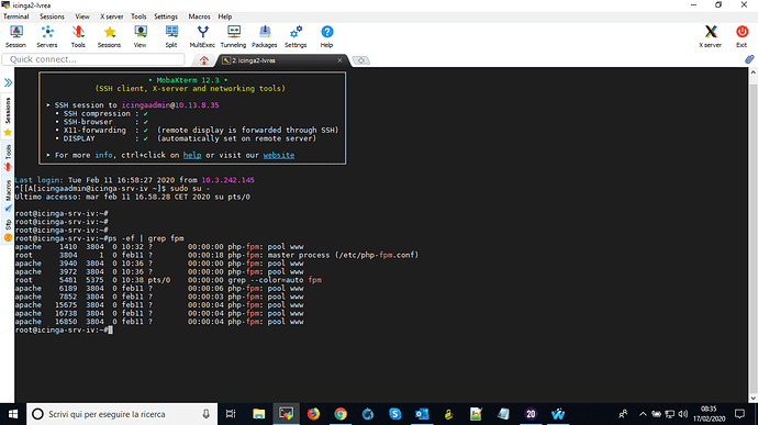

Here the output about php-fpm

Now i’m unable to do any change in Icinga.

Look in /etc/php-fpm.conf for the location of the pid file. Check if it has been removed by accident or some script. If it is there, check its permissions.

Pid file needs to be readable by all (aka 0644 in octal). Inside the config file , there should also be an entry for error logging. Check there just in case.
Permission are right, i’ve tourn on the error log and this is the output when try t deploy
