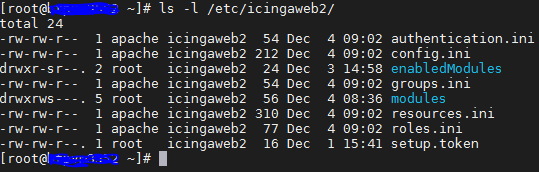

If not please check if the user running the webserver (e.g www-data for Debian/Ubuntu, apache for RHEL/centOS) has permission to write into the directory. There should be a guide displayed at the beginning of the web setup when you have to enter the setup token.

ERROR: Icinga\Exception\SystemPermissionException in /usr/share/php/Icinga/Application/Modules/Manager.php:275 with message: Cannot enable module “monitoring”. Check the permissions for the enabledModules directory: /etc/icingaweb2/enabledModules
permissions
fixed it by running
$ chown -R apache /etc/icingaweb2/
