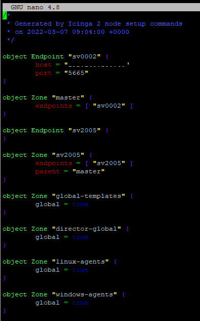

Here is the zones.conf from the master:
Here is the zones.conf from the satellite:
Do you have an idea, why it doesn’t work as expected?

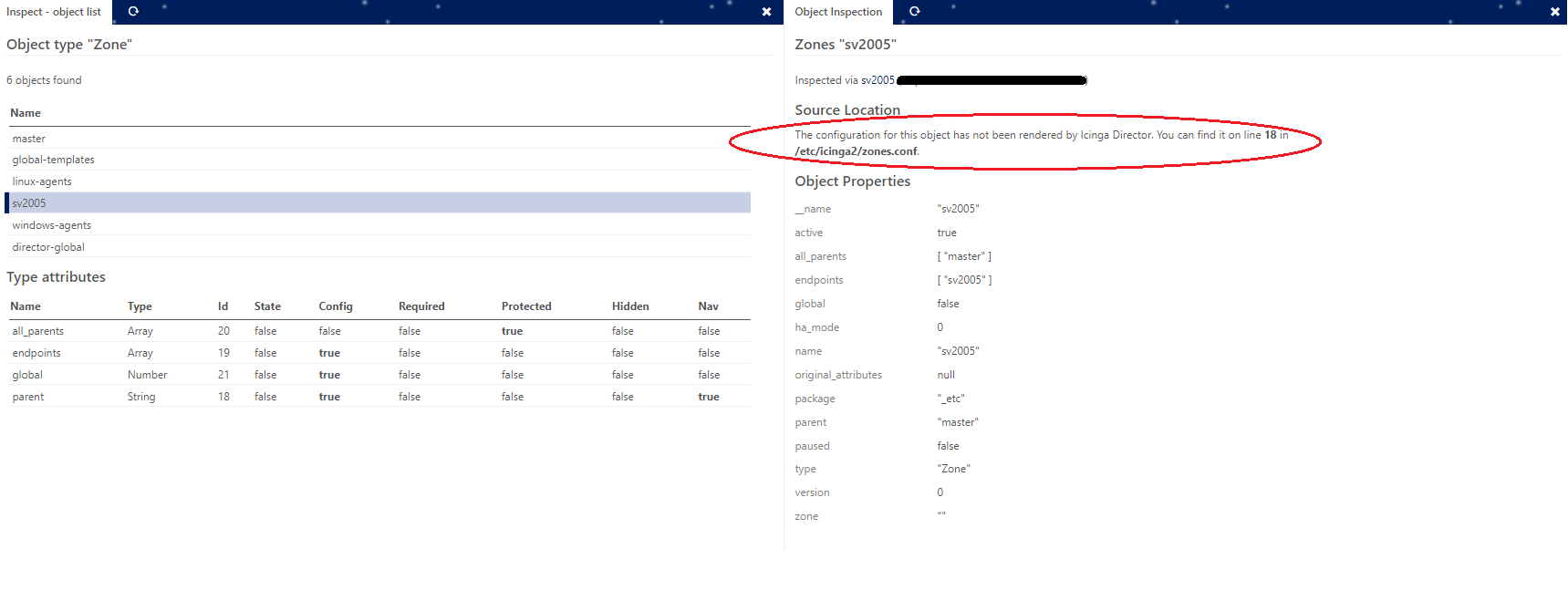

Maybe this is a clue: When I inspect the satellite via director I receive on the zones tab a suspicious “The configuration for this object has not been rendered by Icinga Director. You can find it on line 18 in /etc/icinga2/zones.conf”

Sounds weird since your config shows that the satellite shall connect to the master. Anyway, connect is not allowed. API is enabled?

But I really don’t know, why it says that the satellite zone is not connected :smiling_face_with_tear:
To me it looks like your satellite checks if it is connected to itself.
