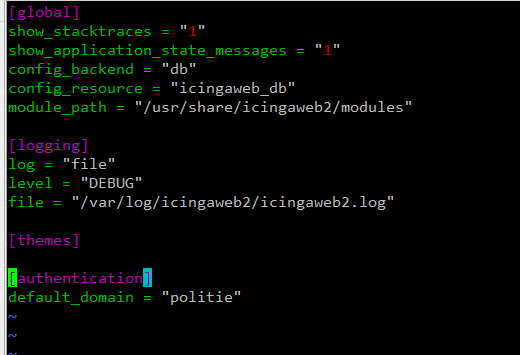

Did you set a default domain in the general configuration?
yes i did:
removing that seems to do the trick
thank you
If you set a default domain, you’d have to include the domain also for all database usernames. (i.e. kiosk@politie)
ok, clear
indeed removing the default domain broke it for the ldap users.
i added @politie to the db user and now all seems good
