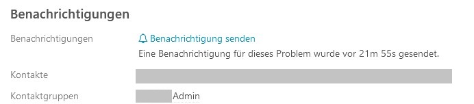

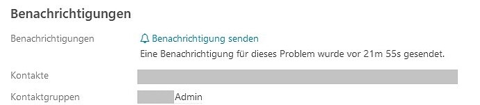

Hi, when I add “Problem” I get everytime a mail, when a sensor change his state to “Critical, Warning, or Unkown”
The subject starts with [problem]…
That shows me that the Benachrichtig basically works?!?
Maybe I should post an error message on github?
