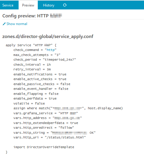

Could you show us what the director is rendering? Go to the preview tab for this. It should look like this, if you click to “show resolved”:
maybe you forgot some parameters.

I meant the result of “show resolved”. To see the complete command definition. Because with this we also see the parameters from your template “http_check”.
A similar result you get with the “inspect” button what @log1c suggests. Here you get the resolved service definition into how icinga calls the check_http-command with all the the paramters you defined in the director.

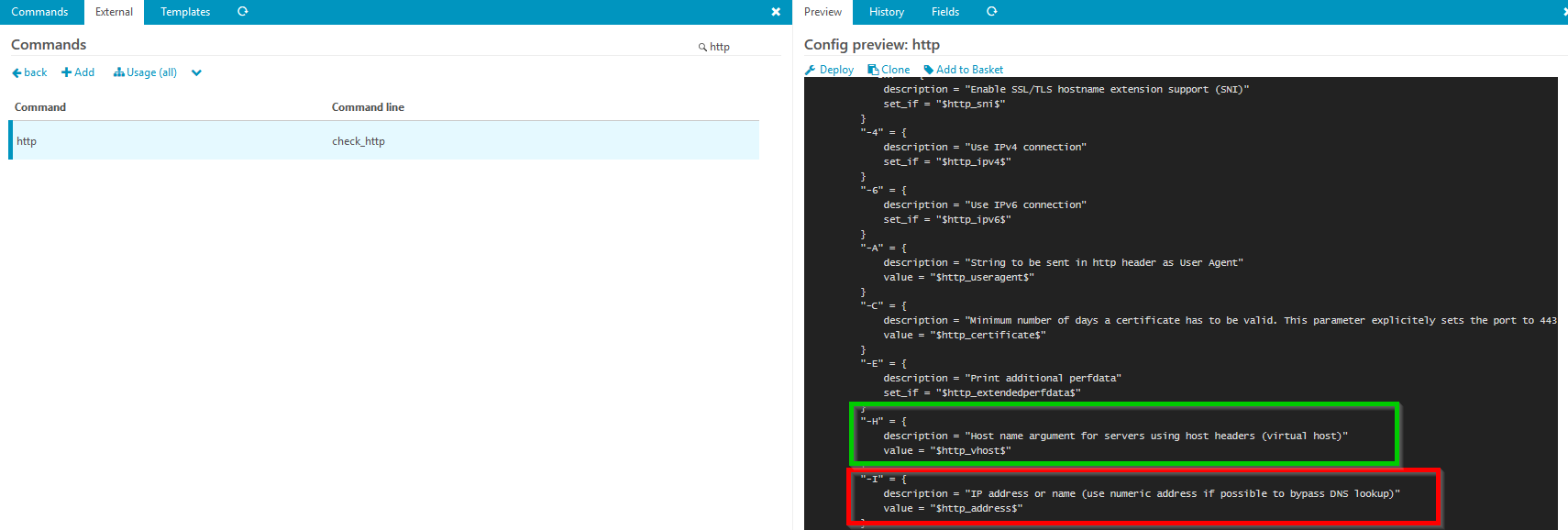

Also take a look at the command definition inside the director so you know which variable fields to use:
http://YOUR-MONITORING-HOST/icingaweb2/director/commands?type=external_object#!/icingaweb2/director/command/render?name=http

If you take a look into the command definition you need an other field than “http_address” if it is working with the -H parameter:
Thank you very much. It works. Issue is solved
