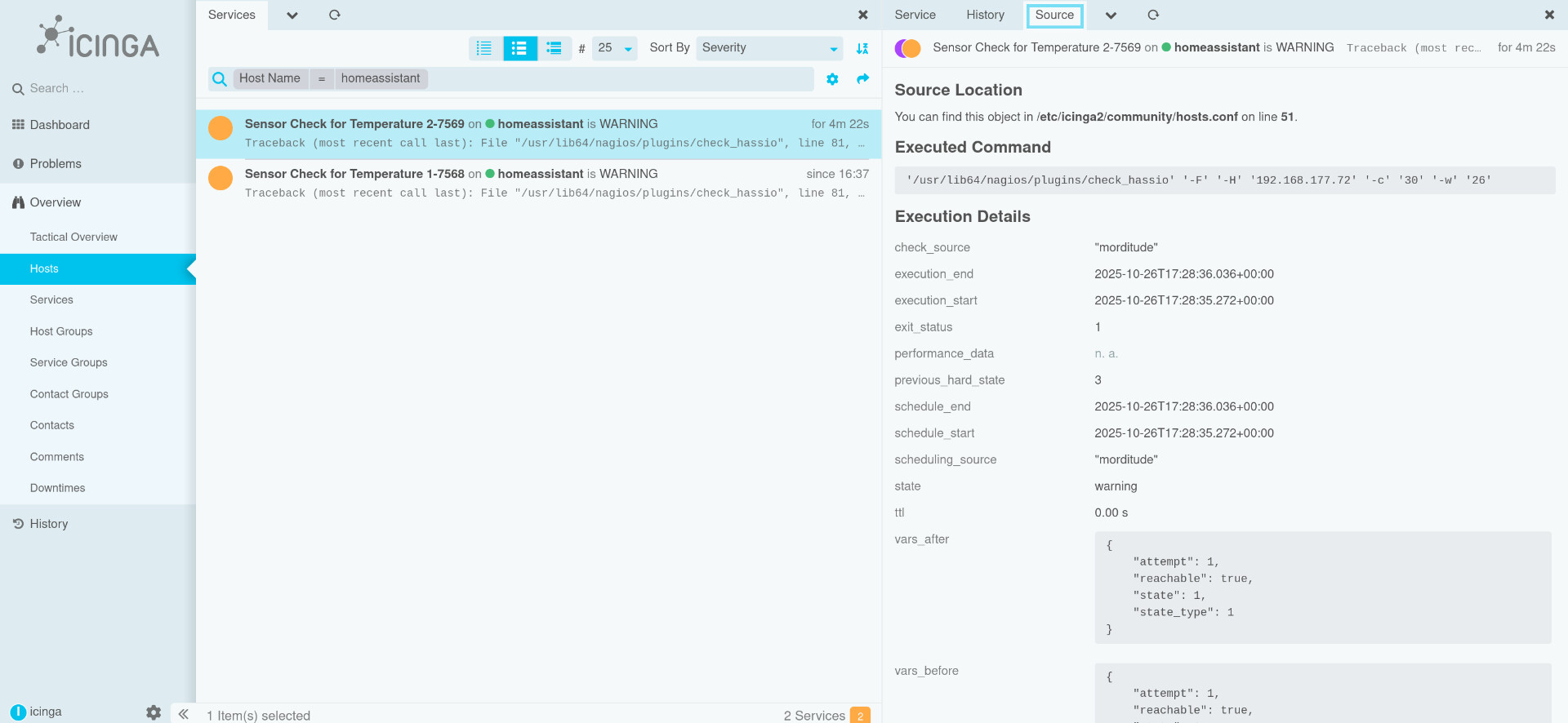

Now, lets check in IcingaDB-Web How many Services on our Host are:
Id say this looks pretty fine. One Host with two different Services, and the Thresholds are getting properly mapped to the right Service. Cheers @penguist
