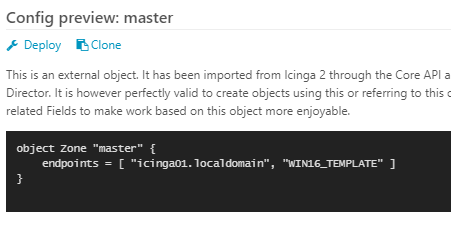

I supposed I had to work with zones and endpoints, but if I go to infrastructure configuration and I add my new endpoint like this:
And then I try to deploy the update I get the error:
If I check my master master zone the endpoint is included:

Did you add that record manually to the Zones.conf, or was this created in the director ?
In general the main /etc/icinga2/zones.conf is not altered by Director but it create the additional endpoints and zones in the /var/lib/icinga2/ files.
