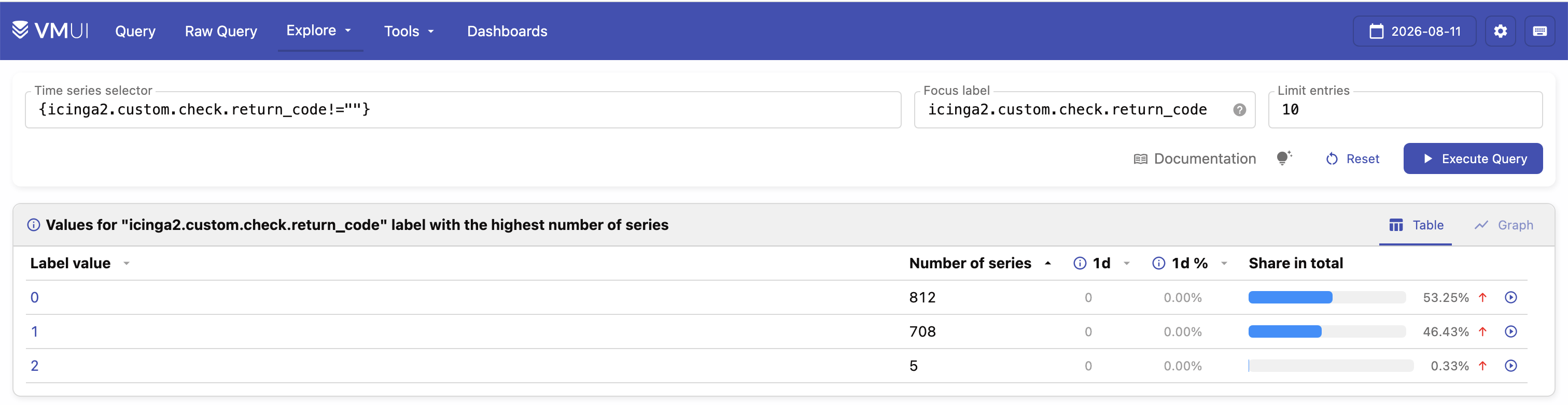

object OTLPMetricsWriter "oteltest" {
  host = "127.0.0.1"
  port = 8428
  metrics_endpoint = "/opentelemetry/v1/metrics"
  service_namespace = "icinga2-test"
  host_resource_attributes = {
    "check.return_code" = "$host.last_check_result.exit_status$"
  service_resource_attributes = {
    "check.return_code" = "$service.last_check_result.exit_status$"
  enable_send_thresholds = true
Thank you so much!
I didn’t think about adding the Exit Status as a label.
This works for me.
