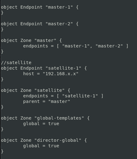

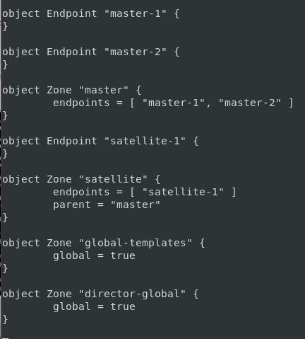

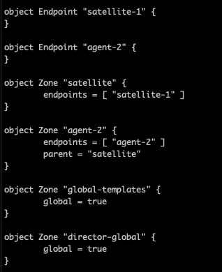

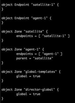

and these are my zones.conf :
Agent-1 :
agent-1
Agent-2 :
agent-2
Satellite-1 :
Satellite-1
Master-1 :
Master-2 :

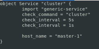

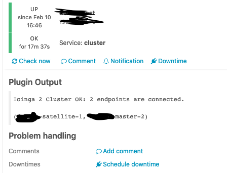

For Cluster check :
Conf file in /etc/icinga2/zones.d/master/cluster.conf
master-1_cluster.conf
And the output of this :
cluster.conf_output
